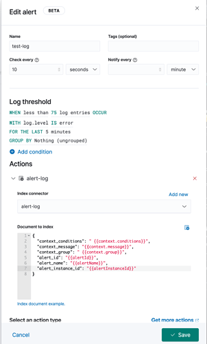

We're using latest version of ELK. In alert and action > Log Threshold, less than feature doesn't work as highlighted in the screenshot
We're intended to get alert when a logsource stop sending logs, here if we change it with more than X number of logs entries then it works and trigger an alert but less than doesn't work.

Did you go to Discover set time range to 30 mins and filter on the host.name : "wp-pri" and type : "auditd" you get a count of less than 2000 if so the alert should fire or perhaps wrong in the logic.
Hmmm there is something interesting going on. It is late where I am at, I will need to take a look tomorrow and perhaps ask for some guidance.
The logic is not working as I understand it... we are trying to mix positive and negative logic.
It appears that perhaps since there are no / 0 documents that match the type and host.name conditions that those conditions are then false and since all the conditions are ANDed that the overall condition is false and thus the alert does not fire.
Your discover showed 0 documents matching... so I think that is what is happening.
I think if there were a couple documents that matched that perhaps the alert would fire.
I will do my best to check, or see if I can get someone else to take a look.
I did verify that if you filter on a term like host.name IS wp-pri and that filter results in 0 Documents you can not use GROUP BY host.name you can not group by the field that returns 0 results.
