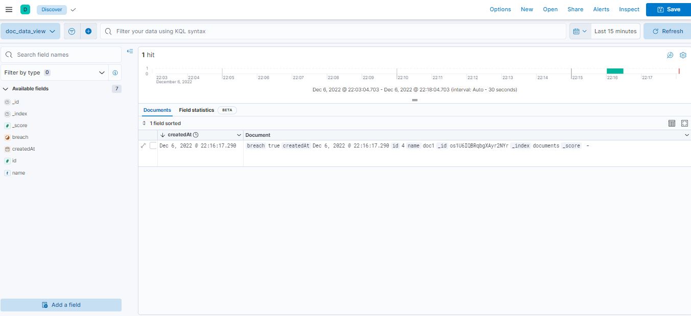

Thank for the reply,
I can see data in data view. I am only getting alert for first time when I enable my rule, after that when I index another doc it does not send alert, rule status shows its active.
I chose Notify option with 'Only on status change' I guess this is where I am wrong, but other two options do not get along with my use case.
