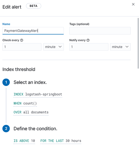

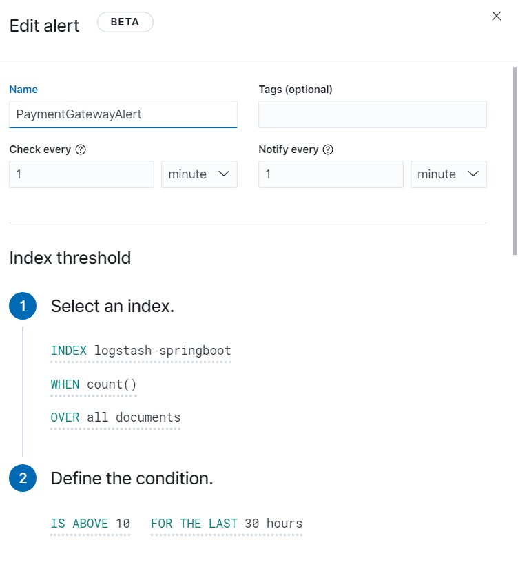

  2. I was trying to make very simple Alert in which Alert should be triggered when events/logs have some "exception" term (count>10 in last 10 minutes) present. But to my surprise I can't do that at this point of time. I can't select the fields from my indexed pattern.
  3. I had used Index threshold and I can't see the field in dropdown conditions.
  4. How can I select some simple search query term in Alert. Is it possible. Please let me know if i can do that?

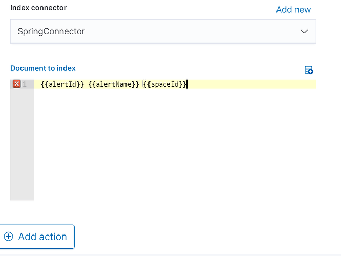

  6. Also, when using Index as Action below error keep coming and Alert was not triggering:
    log [07:27:55.564] [error][plugins][taskManager][taskManager] Task actions:.index "c0090830-9bfd-11ea-887f-afb3323449c5" failed: Error: error validating action params: [documents]: expected value of type [array] but got [undefined]
I have used " {{alertId}} {{alertName}} {{spaceId}}" in Document

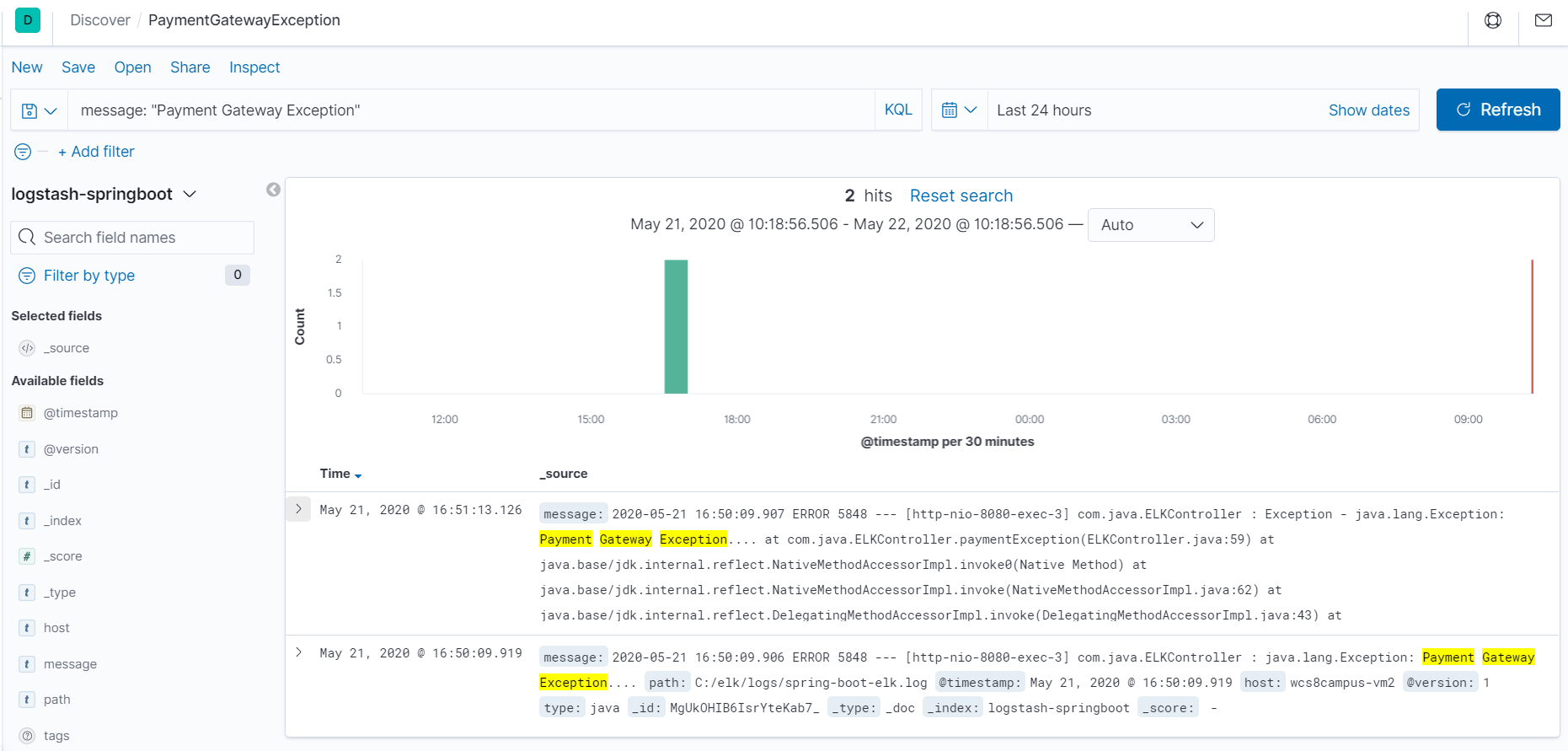

Attaching Discover page where I'm parsing some dummy logs having exception on message field:
Exception

Point 6) Understood the issue and created proper json doc. After preparing it properly in json format it got pushed to Index action configured.
But still how can i use implict variables like {{alertId}} {{context.date}}?
I was only able to send hardcoded data in document. How can i make it more dynamic like sending current date and time or string in doc?
