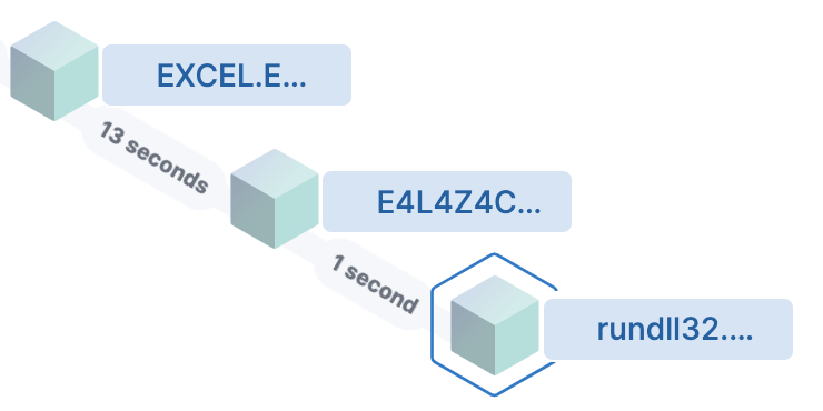

Once the event matches, the resulting analyze event 3D graph generated is:

1) Is it possible to specify to find events in the forward direction (i.e. children of the analyzed process) or in the reverse direction (i.e. parents of the analyzed process)
2) Is it possible to limit the number of events(processes) that are in the graph say we only get 3 events of the same above graph. Something like
The goal of this is to match a subgraph based on a query.

Hey @Sheharyar_Khalid , looks like you're trying to build a query that specifically looks for process descendants, and then, the inverse?
This isn't possible unfortunately. Neither is limiting the events in the graph.
