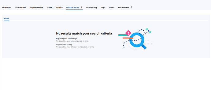

APM - Infrastructure Tab not working for any apm agent
Kibana version:
8.18.0
Elasticsearch version:
8.18.0
APM Server version:
8.18.0
APM Agent language and version:
Python/Java/.NET latest version
Is there anything special in your setup? For example, are you using the Logstash or Kafka outputs? Are you using a load balancer in front of the APM Servers? Have you changed index pattern, generated custom templates, changed agent configuration etc.
Nothing special
Description of the problem including expected versus actual behavior. Please include screenshots (if relevant):
Steps to reproduce:
  1. Add service to APM
  2. Click on Infrastructure Tab
Errors in browser console (if relevant):
No errors
Provide logs and/or server output (if relevant):

Hello there, I have the same problem
I do not see data in the infrastructure tab of the APM APP
I’m using:
  • Elastic Cloud 9.2.0
  • Metricbeat 9.2.0 for default system metrics installed on the Node
  • Elastic-agent 9.2.0 with a kubernetes integration with kubelet, apiserver and kube-state-metrics fully enabled
  • Java apm-agents 1.54 on 4 java test apps in K8s, service.node.name is auto-set to container.id
  • K8s deployment manifest has env vars for enabling metadata: Elastic APM events intake API | Elastic Docs
  • I tested with the system integration on the elastic-agent 9.2.0 instead of metricbeat 9.2.0: no difference
Confusing is this table from Elastic APM events intake API | Elastic Docs:
Environment variable Metadata field name
KUBERNETES_NODE_NAME system.kubernetes.node.name
KUBERNETES_POD_NAME system.kubernetes.pod.name
KUBERNETES_NAMESPACE system.kubernetes.namespace
KUBERNETES_POD_UID system.kubernetes.pod.uid
→ In my apm-traces and apm-metrics documents the values of the fields above end up in different fields, namely:
KUBERNETES_NODE_NAME kubernetes.node.name
KUBERNETES_POD_NAME kubernetes.pod.name
KUBERNETES_NAMESPACE kubernetes.namespace
KUBERNETES_POD_UID kubernetes.pod.uid
Could this be the reason of the infrastructure tab not working?
