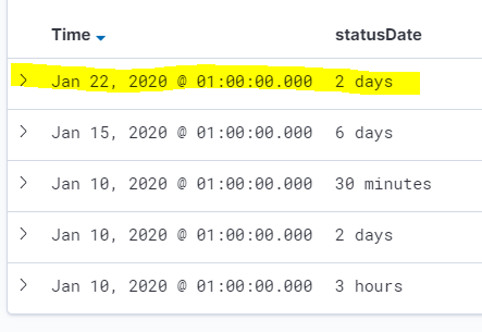

i try to create a new scripted field by calculating the difference(in minitues) between 2 dates in the following format :
bookingStatus.confirmed :Jan 22, 2020 @ 12:20:00.000
bookingStatus.wating :Jan 20, 2020 @ 10:20:00.000
i like the result be like : Xdays ,Xhours, Xminutes
in this case duration = 2 days , 2 hours ,0minutes
i try this expression but i don't get the correct result:
doc['bookingStatus.confirmed'].value.getMillis() - doc['bookingStatus.wating'].value.getMillis()

In your example, you have the following dates:
The difference between those is roughly two days (20th of January to 22nd of January) - the "human readable" format will do some rounding to get a nice representation. It's currently not possible to get an exact duration in a human readable form, to replicate something like this you could try to implement it yourself in the scripted field and return a string instead.

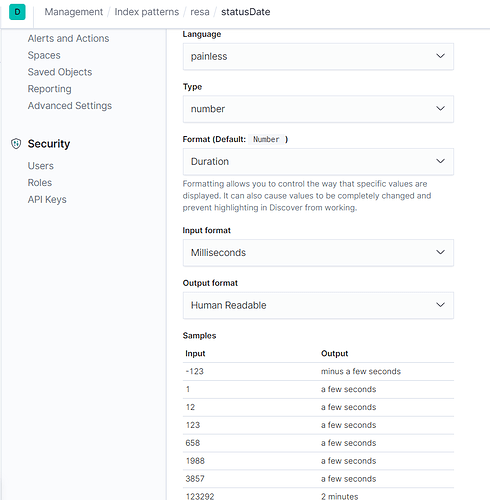

Hi @flash1293 ,
i try with the to methodes:
it's possible to display "statusDate" ( scriptedfield :String ) in a visualization ( X-axe) ?
It's possible to use the scripted field on an x axis, but not as a histogram, but as an ordinal "terms" scale. So the distance between two statusDates on the axis won't be in scale with the duration

I made an error in the first response , i want to display it in (Y-axis)
That's not possible with a string field, you will need to use your original number scripted field with a duration field formatter. The exact value you unfortunately can't show this way.
