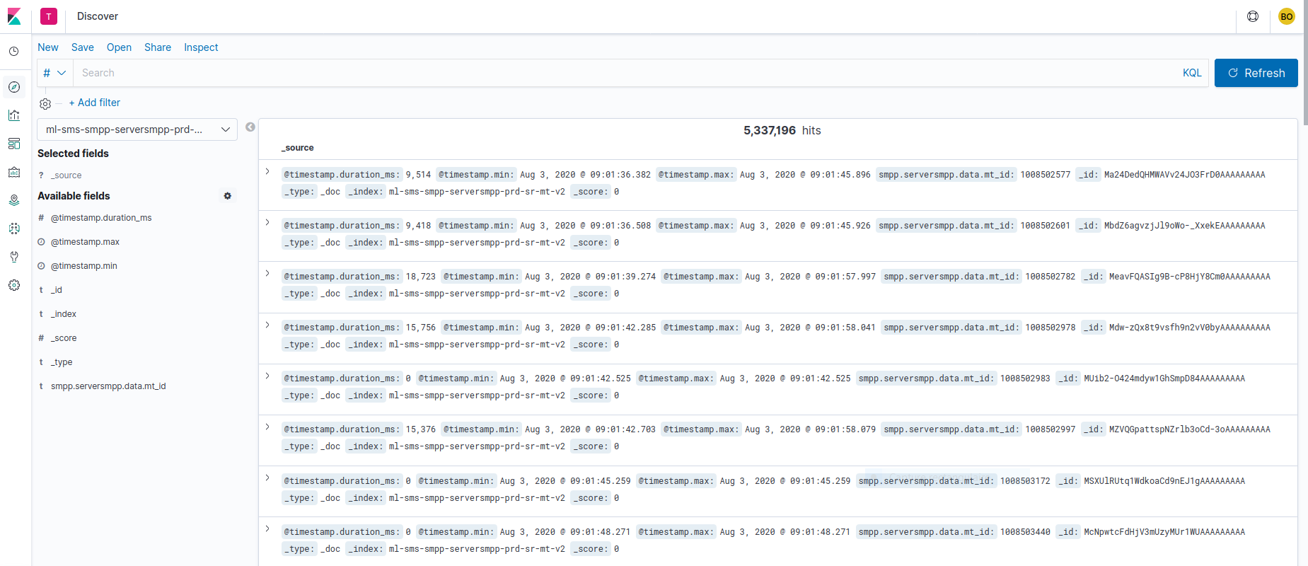

I'm using 7.4 so I did what you said in the second alternative. The problem is, when I had to define a time field, I had only the choice between @timestamp.max and @timestamp.min. I've chosen @timestamp.max but then when I check my index in discover, I indeed have the time controls back but I don't have data anymore. Here is the script that define my Transform:

Hi @Baptiste_Orsoni ,
Looking at your screenshot above, I can see dates in your timestamp.max field, so the data should show up in Discover. Have you tried to select a wider time range?, e.g. Last 1 year?
