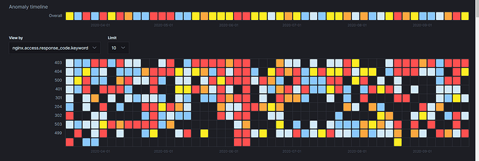

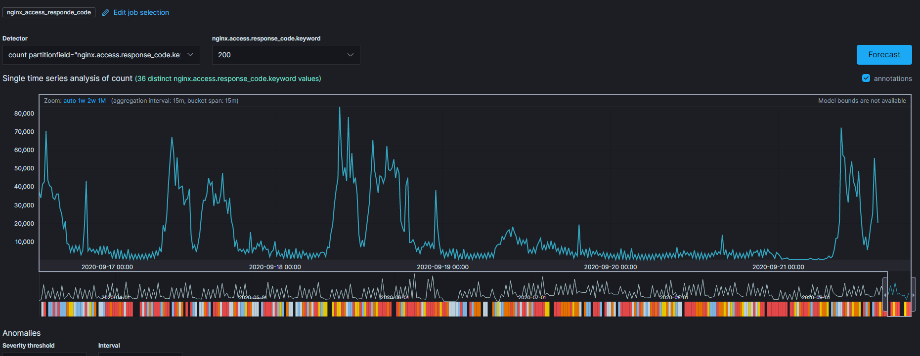

I try to rebuild some chart in ML module include Anomaly exporter and single metric on Kibana.
So can i do that with ML data in ES? I mean what data source that will be use to do this?

All data shown in the ML UI comes from the .ml-anomalies-* indices.
Are you looking to embed these components in a different dashboard? If so, the Anomaly explorer is able to be embedded directly, but the Single Metric View is not (yet).
Follow progress on this here: https://github.com/elastic/kibana/issues/66553
