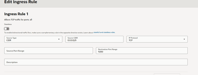

I added port 9200 into OCI firewall rules:
But still I get:
curl -k --user elastic:zzzzzzz -X GET "https://193.1z.z.z:9200"
curl: (7) Failed to connect to 193.1z.z.z port 9200: No route to host
Can you advise how to fix this issue?
