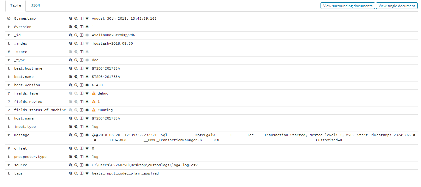

Same Log in Logstash
Same Log in Kibana

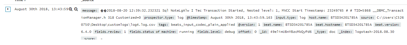

Here is how log is presented in kibana

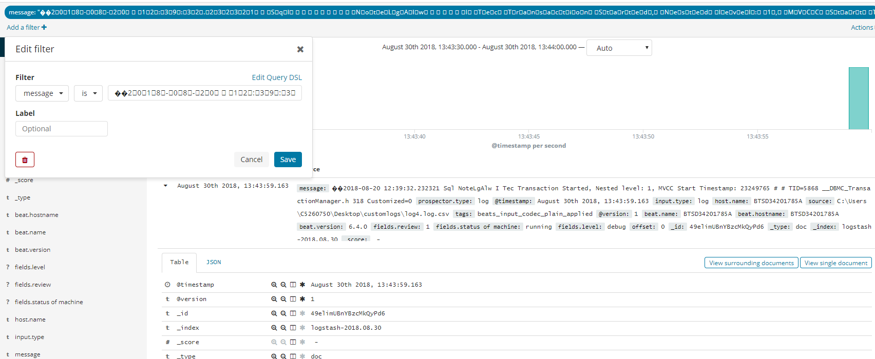

BUT, when i try filter by message, this will happend.
2018-08-30_13-55-42
NO MATCH AT ALL.
I cant filter by massage at all if file from which is log harvested has set encoding as unicode

Well, unfortunately "Unicode" isn't actually an encoding so it's not clear what kind of file you're actually getting from Windows. Judging by https://stackoverflow.com/questions/13894898/unicode-file-in-notepad I suggest you try utf-16le in your Filebeat configuration.
Thanks for your suggestion.
When I set encoding to utf-16 not utf-16le in my filebeat.yml and remove codec => plain { charset => "UTF-16" } from logstash.conf it's resolved my issue. Funny, because i tried it before and it didn't work at all. but it was with 6.2.0 version of filebeat... never mind
So thanks again .
