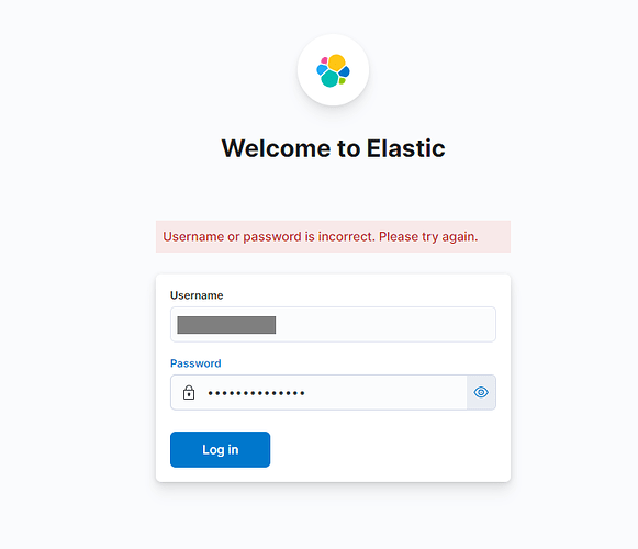

here is the log when user attempt to login: Feb 26 11:55:21 logdev kibana[1784685]: [2023-02-26T11:55:21.243+03:30][INFO ][plugins.security.routes] Logging in with provider "basic" (basic)
I add below config in elasticsearch.yml and restart elastic service but ldap users still can't login.

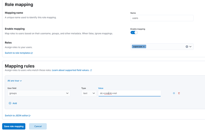

If you added role mapping through Kibana Dev Tools you should take that out.
I did above, but without knowing your groups there is no way I can provide a sample
There are many samples here
I would make a very simple role mapping first.

@stephenb Should consider group? I only need to set OU, that in my case is “users”.
