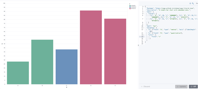

It didn't work, may I know if there are any other ways through which I can give color of the bars using the hexcode in 'v' field.

    "color": {
        "field": "v"
Hi @flash1293
I want the colors that are used in field 'v' for example #000000 is black, I want A and B bars to be black in color.
Ah, gotcha.
