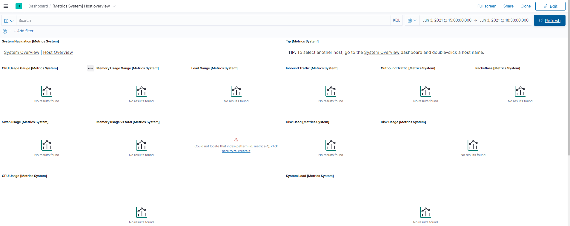

Also, I tired setting up metric beats following your instructions and instructions from the guide, and I was not able to. It looks like metricbeat is able to successfully setup dashboards etc. it sends data out to elastic but most charts in dashboards are not working.
Host overview seems to be working fine (except of time)
Is metric beat setup procedure different than packet eat and wingbeat ?
https://www.elastic.co/guide/en/beats/metricbeat/7.13/metricbeat-installation-configuration.html
