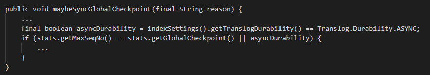

@HenningAndersen, thanks for your reply. @DavidTurner mentioned GlobalCheckpointSyncAction, I noticed that we have the following logic in IndexShard.java to trigger the action. However, if we are not using asyncDurability, the action would not be triggered, right (suppose global checkpoint is behind MAX_SEQ)? Or do we have other chances to tirgger that action?

maybeSyncGlobalCheckpoint runs periodically and regardless of the durability setting it syncs the global checkpoint if stats.getMaxSeqNo() == stats.getGlobalCheckpoint(), which is a way of expressing "no operations in flight".
But based on my analysis above, we could have stats.getMaxSeqNo() > stats.getGlobalCheckpoint(). And to make global checkpoint to cache pu to MAX_SEQ, we have to trigger GlobalCheckpointSyncAction. However, since stats.getMaxSeqNo() > stats.getGlobalCheckpoint(), the action won't be triggered.
With request-level durability every operation is properly fsynced before responding to the primary. This means that the last operation to complete on each copy will advance that copy's (persisted) local checkpoint up to the maximum sequence number and then tell the primary about it. Note that these things don't necessarily happen in sequence-number order, so the last operation isn't necessarily the one with the highest sequence number, but that doesn't affect the argument. Once all copies have completed all operations this means that the global checkpoint (on the primary) should indeed equal the maximum sequence number.
In some sense this is why we have to handle async durability differently in maybeSyncGlobalCheckpoint: with async durability it isn't true that "no operations in flight" implies stats.getMaxSeqNo() == stats.getGlobalCheckpoint() so we must be conservative and do some extra work to make sure.
