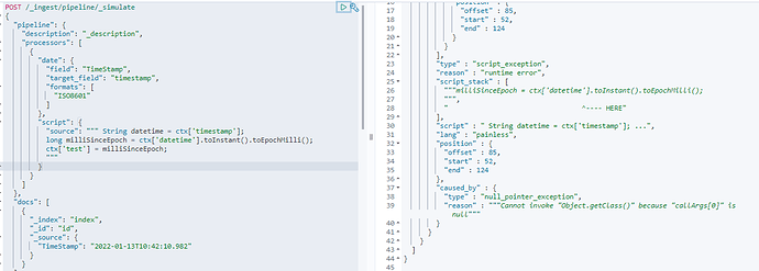

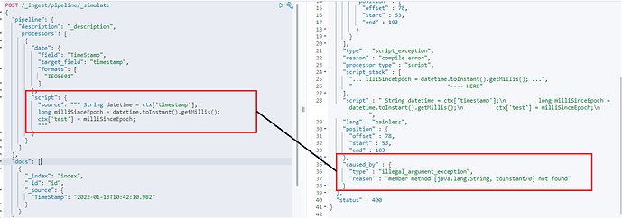

I also tried with this script which leads different error. Please refer screenshot.

it looks there is no 'datetime' in ctx. ctx[datetime] should be datetime, isn't it?

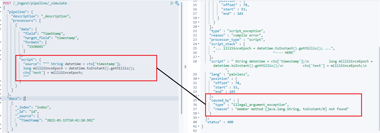

I tried even with TimeStamp that exist in ctx. same error.
Without ctx on timestamp
with ctx on timestamp
