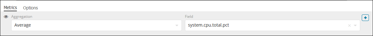

I have my CPU metrics coming up and have been visualizing them using the Visual blinder in time series, every thing seems fine but when today suddenly the CPU from one of the BOX went to 100% , i was unable to see the same on the graph, as it's showing a peak of 4 and it's not showing beyond

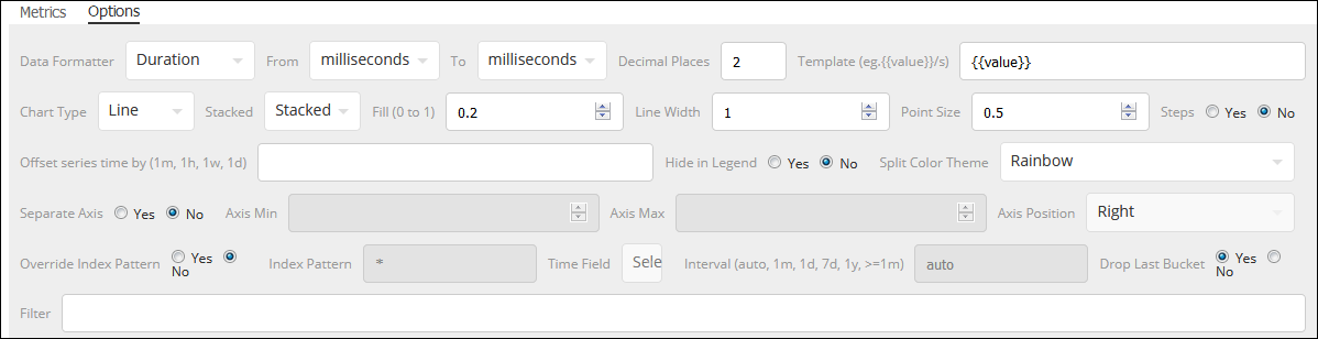

the panel options are as below
please help on this to capture 100 cpu utilization
Thanks in advance
The reason it is 4 is because you probably have 4 cores on your machine so it's 400%.
If you want to make sure that it's capped at 100% you must used the normalised percentages: https://www.elastic.co/guide/en/beats/metricbeat/current/metricbeat-metricset-system-cpu.html
In addition to what @ruflin said, the Data Formatter should be percentage, not duration.
