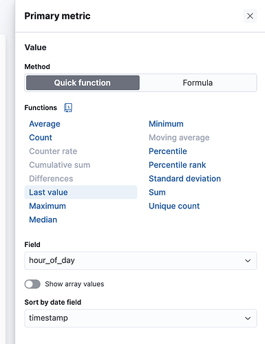

@Jospaul you could do it with Lens. So the steps are:
  • Create a metric in Lens and select the last value of the field you want
  • Then go to breakdown and add the top values and on the same panel select Sum on the collapse by
The metric is going to have the sum of the last values
Thanks @Stratoula_Kalafateli It's showing the expected value . Thanks much.
