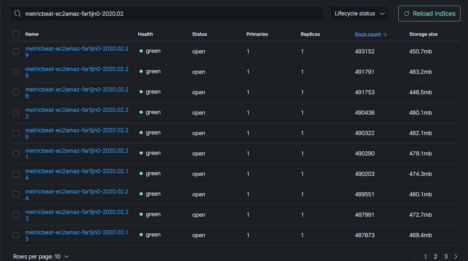

Indices:
I can understand that the indices were all little heavy with 400000+ documents approx, but will that take this long(17+ hours and still executing) to complete?
I also tried to reindex a single index with just 479 documents and it is working for more than 5 hours.

So, a reindex is not necessarily a rapid process, especially if you have other ingest events going on.
Additionally, without specifying otherwise (by setting a slices option), a reindex is a single-threaded operation, making it potentially even slower if other indexing or heavy I/O traffic is happening.
Was this request made while:
  1. Regular ingest was happening
  2. The big reindex was happening
If so, you added a third or fourth I/O heavy operation as a single thread, which could explain the slowness.
How large is your cluster (how many data nodes)?
On a separate note, Is there any way you can change metricbeat from doing daily indexing to using rollover indices? It would remove the need to reindex altogether by only rolling over to a new index when a total size in GB or number of docs or age of data is reached. It is the preferred solution.

Okay, so that's 3 data nodes which are also master eligible (which is a bit different from 2 dedicated data nodes and a single master—you can see that all 3 are data, 2 are listed as master eligible, and 1 is master). Also, these data nodes having only 8G of RAM means this is a relatively small cluster in terms of CPU and memory.
Since it is not a large cluster, CPU and I/O are going to be a bit limited. A reindex is definitely going to go slower on this cluster, and slower still without setting slices to a higher number (if unset, the default is 1, meaning 1 single-threaded query feeding the reindex).
Also, the speed of a reindex isn't tied to Curator itself. Curator merely starts the process with a _reindex API call, which is then managed locally by the cluster itself.
