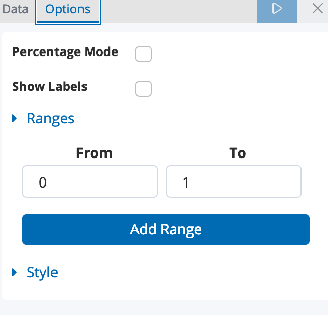

My Kibana metric field is selected via "max" aggregation and then the name of the field. No buckets are selected and under options. In addition, i've tried all variations under options to try to obtain a different result with not luck.
