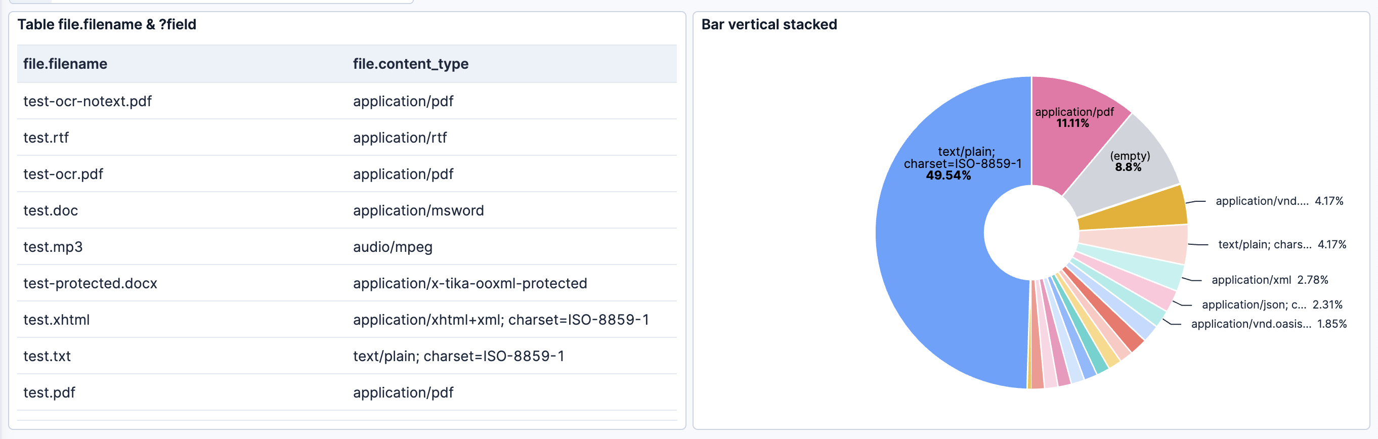

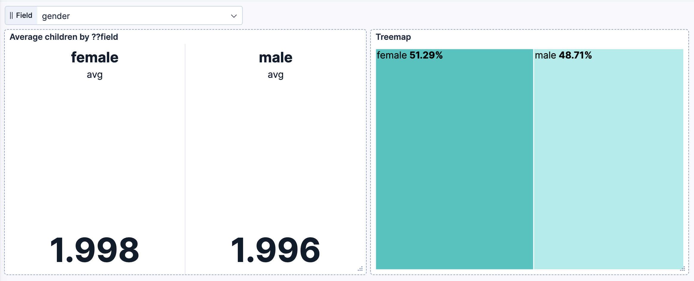

I'm doing something which looks a bit similar where I can select a field name from the dashboard and inject this field name in the ES|QL request.
FROM person
| STATS count = COUNT() BY ??field
| LIMIT 100
I'm doing that in Elastic Serverless. Not sure if it's possible in 9.0. You might have to wait for 9.1???
IMHO it's a super nice feature that have been asked for years and is now here...

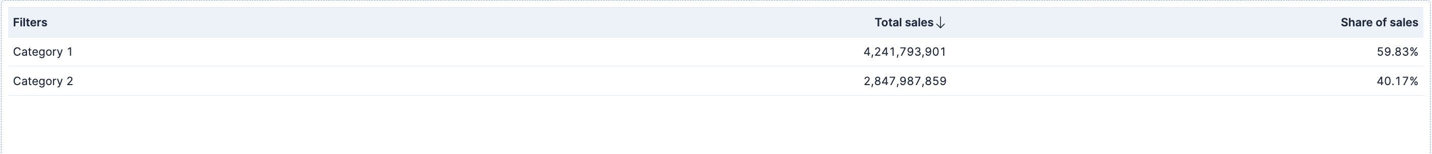

F ex in a lens table that has split rows on categories, I want to be able to show the share of total sales for each category. This is possible to an extent using a formula like sum(total_revenue) / overall_sum(sum(total_revenue)) but that does not work when filtering down on one of the categories.
I think it would be very powerful to be able to set a dashboard variable like total_sales = sum(total_revenue) that ignore any filters, which can be used in a formula f ex sum(total_revenue) / {{total_sales}}

I can find it when creating a dashboard, and adding a Panel ES|QL, then when writing the ES|QL query, it sometimes appears. See "Create control" in the above screenshot.
Which gives at the end something like:
HTH
