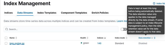

Hi there,
I was wonderig that the manual says this:
A value in the data retention column indicates that the data stream is managed by a data stream lifecycle policy. This value is the time period for which your data is guaranteed to be stored.
URL: Index management in Kibana | Elasticsearch Guide [8.18] | Elastic
But why does in my case the data retention show ‘disabled’ if ILM is turned on for this data stream? Should it not show a number there instead? I have defined a delete phase after 40 days.
Also interesting is the content of the online help. So are there 2 different kind of data retention definitions in place?
I would appreciate some insinght.
Thanks!
Yeah, this is confusing, the documentation you shared is for data stream lifecycle, it is not the same thing as ILM.
If you have ILM, the retention is managed by the ILM policy, the Data Retention column you see in Kibana only shows information if the retention is managed by a Data Stream lifecycle, so if you are using ILM it will shows up as Disabled.
I'm not sure exactly what is the main difference as I found it confusing and just stuck with ILM, it seems that they do basically the same thing, but in some different way.
