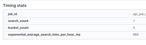

Please find also:
  • job messages related to api_job_device1:
  • datafeed stats related to api_datafeed_api_job_device1:
datafeed_stats
