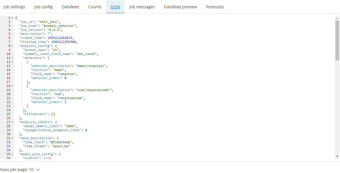

4. My job config
5. JSON file

It looks like the main crux of your problem is that although you have 100k+ documents in Elasticsearch, they all have the same timestamp. In logstash, you must have not properly extracted the timestamp from the logs and used that to write the @timestamp field (??) See the "Date filter" section of: https://www.elastic.co/blog/a-practical-introduction-to-logstash
The ML job needs to see documents over long-ish periods of time (hours, days, weeks, etc.). Until you fix the timestamps, your ML jobs will never work.
