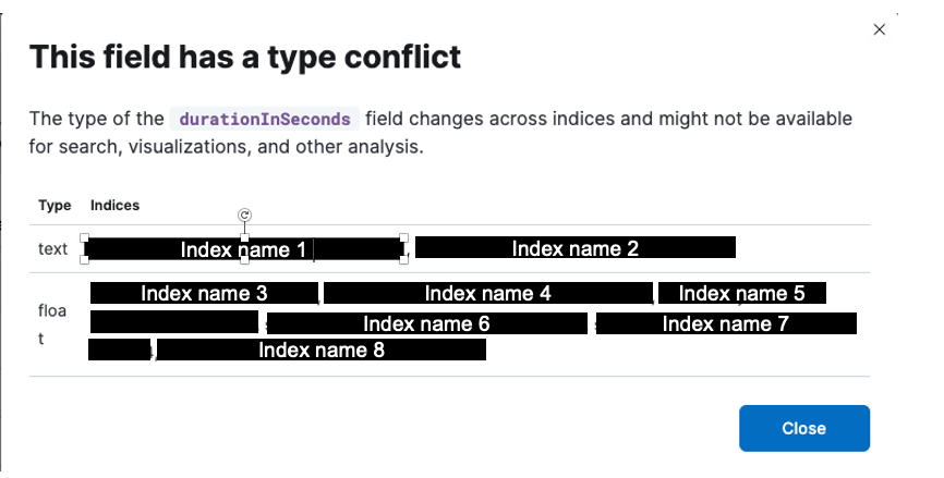

Go into the data view, and it will show a banner telling you how many fields have conflict, click in View Conflicts to filter by those fields, then on the list, on the Type column you can click on conflict to show the type of the field in each index.

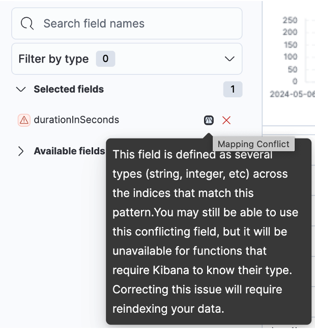

The data does appear in Discover with the below warning attached. I am unable to use it in visualisation charts.

You need to go to Stac Management, Index Patterns, look for the index pattern where you have the conflits, there you will see more information about the conflicts.
Sadly, this only gives me the name of the index and the type mapped to it (dynamically).
Yeah, this is exactly what I told you to look for.
With the index name you need to look in your system what is writing to that index and then fix the mapping, there is not much you can do as conflicts are mapping issues and you need to fix the mapping issues.

A mapping conflict means that your index pattern/data view matches two or more indices where the same field has different data types.
In Kibana you can check the index pattern and see the data type for the conflicting field in each index.
To fix this conflict you need to create a template/mapping with the correct data type and reindex your data,
But you won't be able to find what is the source of the documents that lead elastiscearch to interpret the field as a different data type, unless you are tagging or adding custom fields to each source.

The thing here is that you are using dynamic mapping and with dynamic mapping elasticsearch will try to infer the mapping of the field based on the first time it receives a document with the field and its value.
In your example durationInSeconds, you may have a document where the value was "10.5", and because of the double quotes it may be intepreted as a text, while 10.5 may be interepreted as a float.
You have the index name where this field is mapped as text, you can then filter by the index name and see all the documents present on that index, since you have some fields that can identify the source, maybe this will be enough.
You need to fix this in the mapping, changing the source is not a fix as the mapping is created by Elasticsearch.
Exactly. I won't be able to identify the source this way. So, a mapping template must be only way. It's just we have been running for years with no problem until now so wanted to avoid if at all possible.
