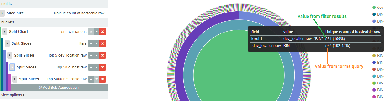

I have questions about results differences between filter and terms (i'm using unique count).
By using filter, i get 531 value, the same result compared with the docs that presented (531). But if i use terms, i get 544 value, bigger result compared with the docs that presented (531). If i count the docs, it is 531 documents.

is it possible that some documents contain an array of data on the field you are aggregating on like field: ['foo', 'bar'], so that they fall into two buckets?
Also, can you clarify what you refer to as unique count in this context? Maybe I am misreading this.

It doesn't have any array. The unique count is for a port number of a switch, example: BIN-SW-01 Fa0/1. So, "BIN" refer to location of the switch.
