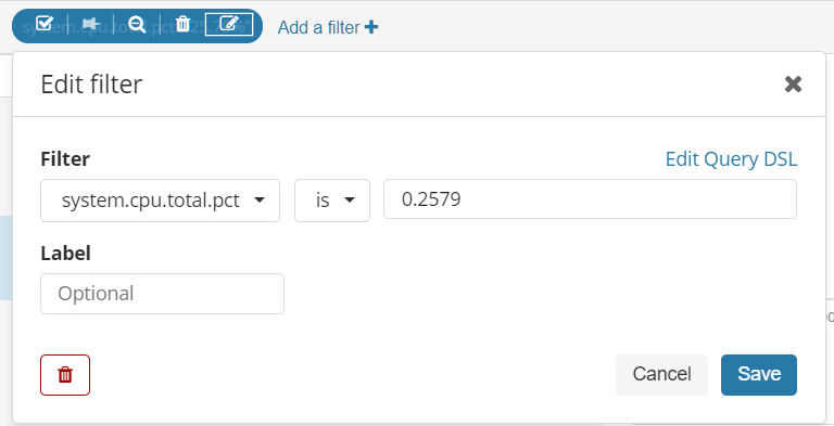

I could be wrong there. When I add a filter by clicking on some percentage number value I get this, which appears to be searching for a string;
But if I edit the filter I get the decimal number;
And one step further to Edit Query DSL I see this;
Can you check your filter and see if it's really doing the numeric query?
