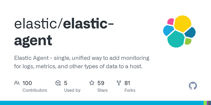

I found the k8s ymls for the Elastic agent here:
