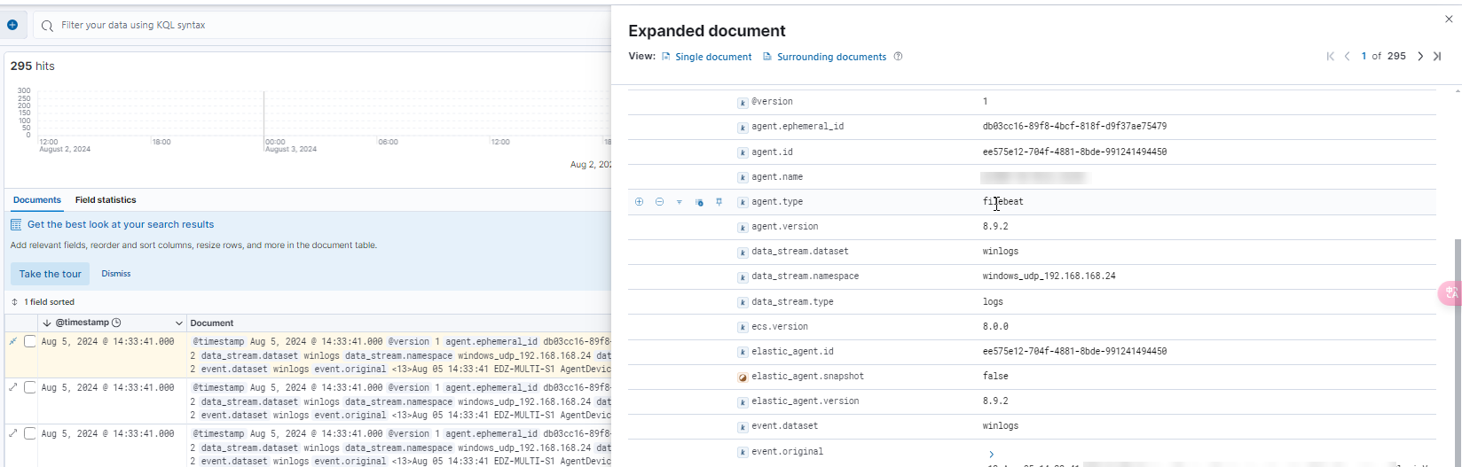

However, when I view the logs in Kibana, I've noticed that the fields are not being parsed as expected by the Elastic-Agent. I am seeking guidance to understand the possible reasons and solutions for this issue.

Please share how the logs looks like in Kibana.

Additionally, I am using the Custom UDP Logs integration to send Windows event logs. The Ingest Pipeline uses logs-winlog.winlog-1.20.0, but the Elastic-Agent is not parsing these fields as expected. What might be the reason for this?

You need to share how the message field looks like, also try to not mix up the issues as this make its harder to troubleshoot.
Please share the information about the Fortinet integration, not the windows one, share how the event looks like in Kibana, including the message field and the integration configuration.
