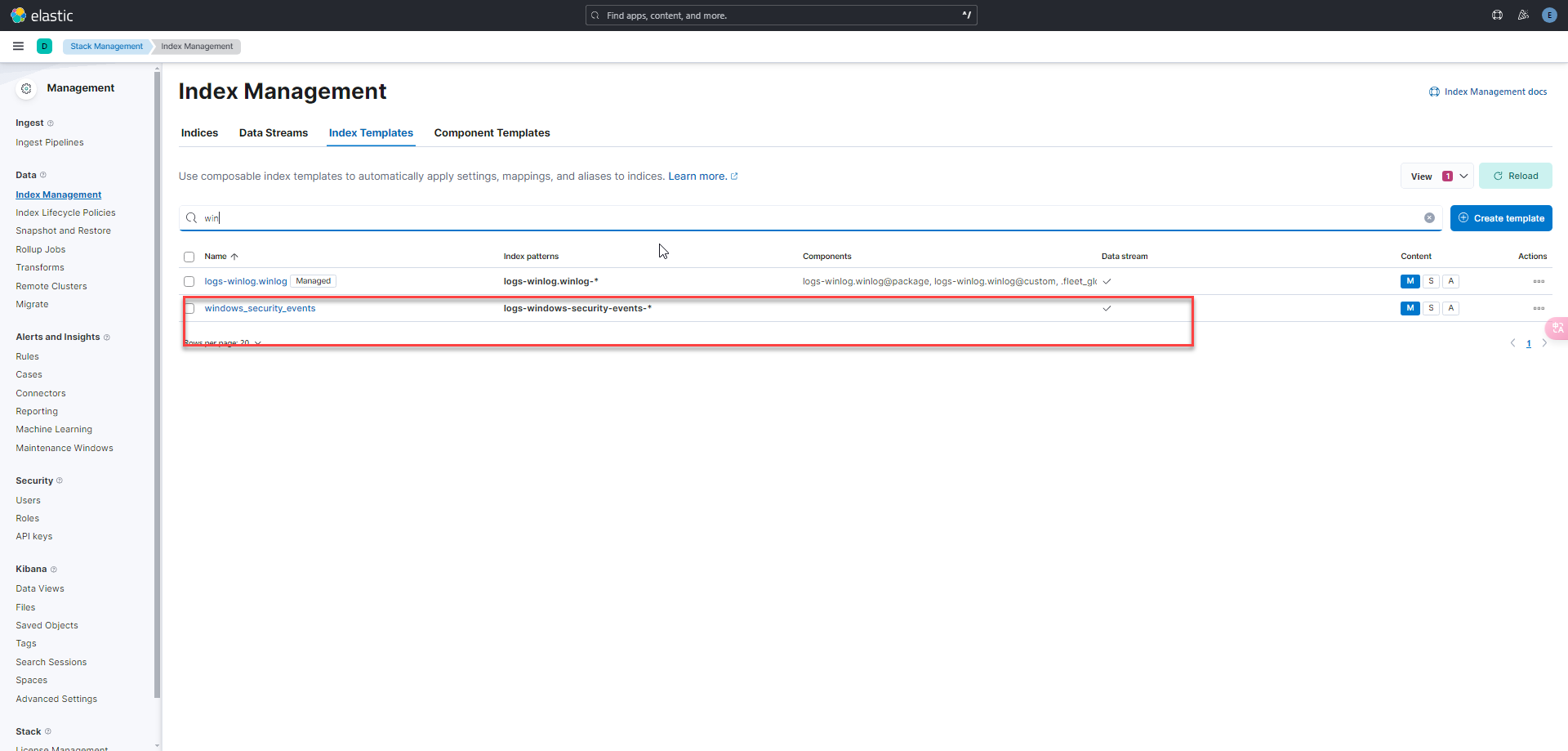

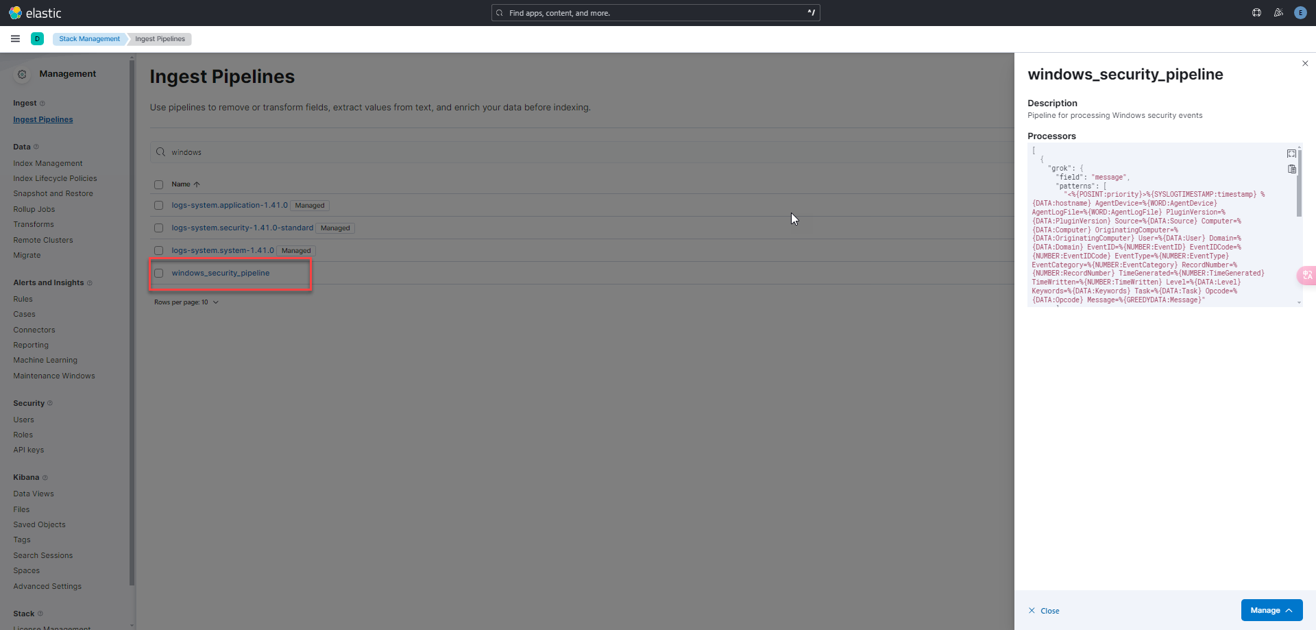

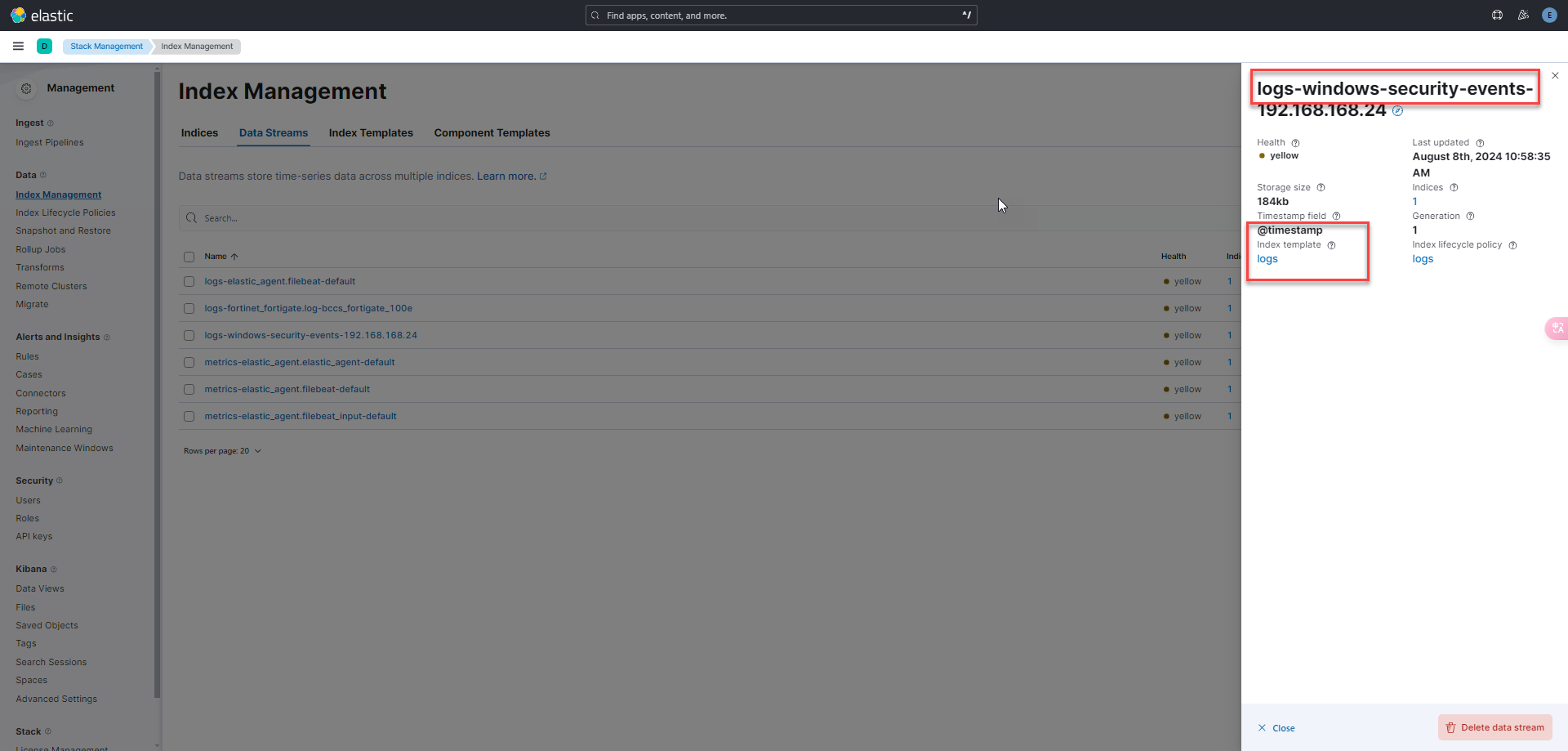

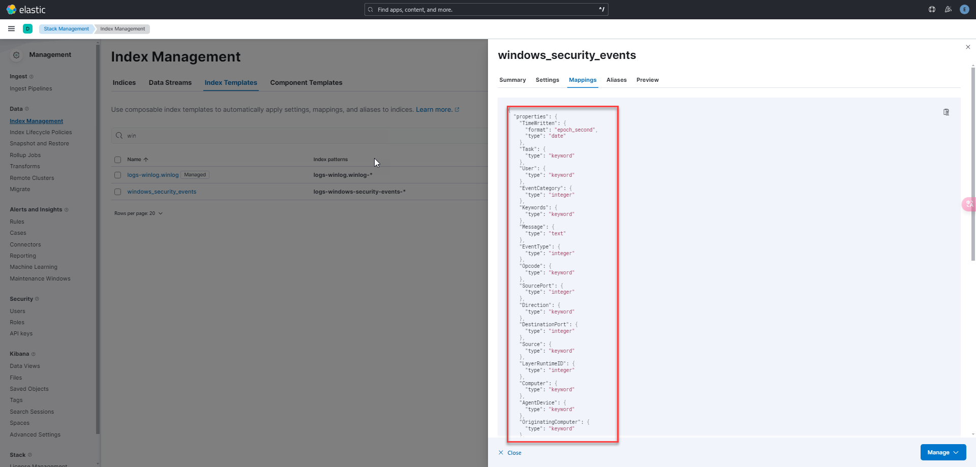

I have set up index templates and custom ingest pipelines to parse these fields. However, the index template created for Custom UDP Logs is always 'logs-'. To successfully parse the fields, it should be the 'logs-windows-security-events-' that I established. Do you know where the problem might be? Any advice would be appreciated. Thank you.

But looking at the configuration you shared there is at least one thing that is wrong, the dataset name.
You are using the dataset name as windows-security-events, but you cannot use this, there is a message bellow the Dataset name that says that you can't use the minus signal (-) in the dataset name.
Also, you are trying to change too many things at the same time, this makes everything harder to troubleshoot and understand what is not working.
You are trying to use a custom parsing, a custom mapping and a custom dataset name.
Another thing is that you enabled the Syslog Parser in the integration, but you are also trying to parse the raw message in your custom pipeline.

First make sure that you are receiving the logs, unparsed, in the default dataset for the UDP integration, it is udp.generic if I'm not wrong.
After that, change the dataset to something custom, like windows_security_alerts and make sure that the events are arriving in that dataset.
Then enable syslog parsing and check how the message is transformed and what you need to parse.
After that you can create your parse in the custom ingest pipeline and then adjust the mapping.
