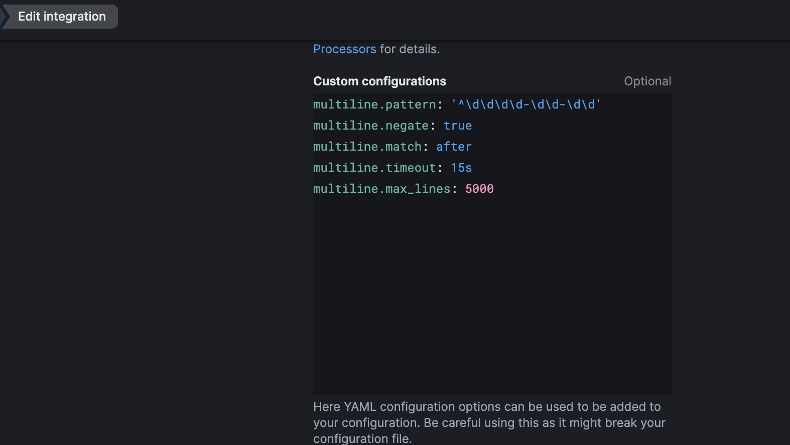

Hi,
Ran into issue which is quite puzzling. Referred to the official docs and some topics in this forum but it did not help.
I am trying to ingest custom logs via integration within elastic agent. Everything is working except that it does not go through the pipeline, no matter what I do.
Tried:
  1. Putting pipeline: db2logs into "custom configuration". But after doing this, logs does not get ingested at all.
  2. Updating the index via API using:
PUT .ds-logs-db2-default-2023.03.09-000001/_settings
  "index.default_pipeline": "dblogs"
But it has the same result as (1).
Here's some screenshots of my current configuration without (1) and (2).
As you can see, it is running the multiline parser correctly and ingesting the logs properly. But it just can't go through the pipeline. Tried running a simple pipeline doesn't help either.
Anyone has any idea on what should I look for or try? Appreciate any pointers here.

INSTANCE: db2inst1             NODE : 000            DB   : ASSIST
HOSTNAME: pksdc2pdb01
EDUID   : 60381                EDUNAME: db2hadrp.0.1 (ASSIST) 0
FUNCTION: DB2 UDB, High Availability Disaster Recovery, hdrSendRedirectMsgToOneAddress, probe:31070
MESSAGE : ZRC=0xFFFFFFFF=-1
DATA #1 : <preformatted>
The HADR primary was not able to form a TCP connection with the standby: 10.20.7.11:51002.
          "dblogs.log.message": [
            """MESSAGE : ZRC=0xFFFFFFFF=-1
          "dblogs.hostname": [
            "pksdc2pdb01"
          "tags": [
            "db2logs"
          "@timestamp": [
            "2022-10-29T14:52:30.073Z"
          "temp.dblogs4": [
          "fingerprint": [
            "PBTBOzjBaGXNsEMZbIxJknMjG5J47c0Btr30J0GpYfJQRhZLVcQOyyBkSz2Jp6e4LKQRFDHqcgpsOAoRUiNCWQ=="
          "dblogs.instance": [
            "db2inst1"
          "temp.dblogs3": [
            """ : 000            DB   : ASSIST
          "dblogs.time": [
            "22:52:30.073009"
          "dblogs.datetime": [
            "2022-10-29T22:52:30.073009"
          "temp.dblogs2": [
            " : 46999353157376  PROC : db2sysc 0"
          "dblogs.function": [
            "DB2 UDB, High Availability Disaster Recovery, hdrSendRedirectMsgToOneAddress, probe:31070"
          "temp.dblogs1": [
            "480 I8038702E535          "
          "dblogs.log.level": [
            "Error"
Alright. Let me test it further later today. It's Friday and I would buy you a beer if you are in Malaysia :slight_smile:
As for the _id, the idea is that we might be ingesting duplicated logs. Hence, instead of creating several documents which is the same, it will "update" the documents instead since the _id are the same. We are using "datetime" as the hash, thinking to use other fields as hash but did not go deep into that yet.
