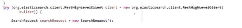

Hi @Sylvain_Juge ,
I tried implementing the query using elasticsearch java client. In the initial research , I found few references on internet that use TermsBuilder for the aggregation part of the query ( "aggs": { "service_name": { "terms": { "field": "service.name", "size": 10 } } } )
However, When I try the same there are no imports found for TermsBuilder.
Apart from this, I also tried using AggregationBuilder but that gives me compilation error as there's no inbuilt method in the builder AggregationBuilder.terms("service_name").
I am unable to proceed with the query as I am not able to find a suitable way to add aggregations to my query in java. Please suggest.
I am using below two maven dependencies:
  • elasticsearch-rest-high-level-client version 7.17.8
  • elasticsearch-java version 8.5.3
While declaring the restclient I am getting below issue
Am I using the correct dependencies for java client and highlevel rest client. Please advise.
Thanks & Regards,
Namita
Hi @Namita_Jaokar ,
Unfortunately, I am really not familiar with the Elasticsearch Java client nor its API.
What I know though is that you should use the version that matches your stack version and do not mix 7.x and 8.x like you did.
Also, I would recommend trying to stick to the 8.x version to make your code more future-proof. While the 8.x Java client relies on the "REST high level" client, it provides a more modern API. see docs for more information here.
