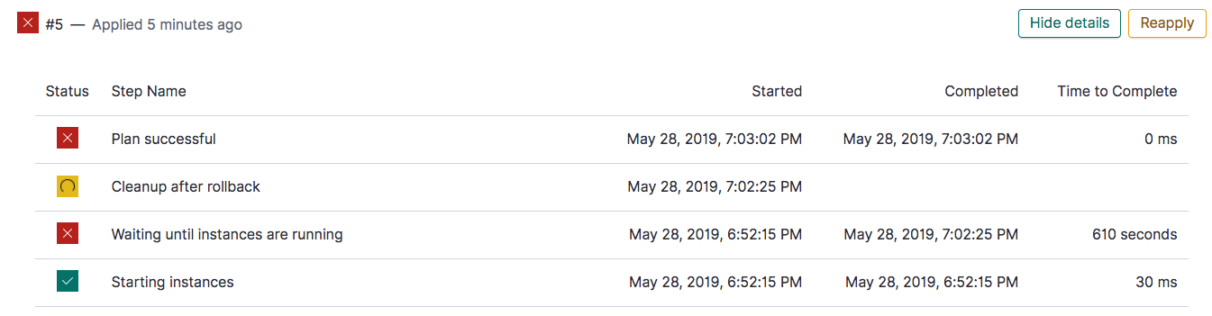

I am following the documentation of the link below to activate the login with SAML in kibana however I always receive a message saying that the changes could not be applied.
https://www.elastic.co/guide/en/cloud/current/ec-securing-clusters-SAML.html
The necessary changes in elasticsearch seem to be applied because it does not return any errors, but in kibana I can not. Has anyone ever experienced this? It does not have any details in the log, it says to try again and if the problem persists contact support.

At the moment the updates were successfully made in kibana, I did not make any changes I just tried several times.
It's redirecting correctly to the IdP inclusive, it looks fine, but it's weird having to have tried it several times.
