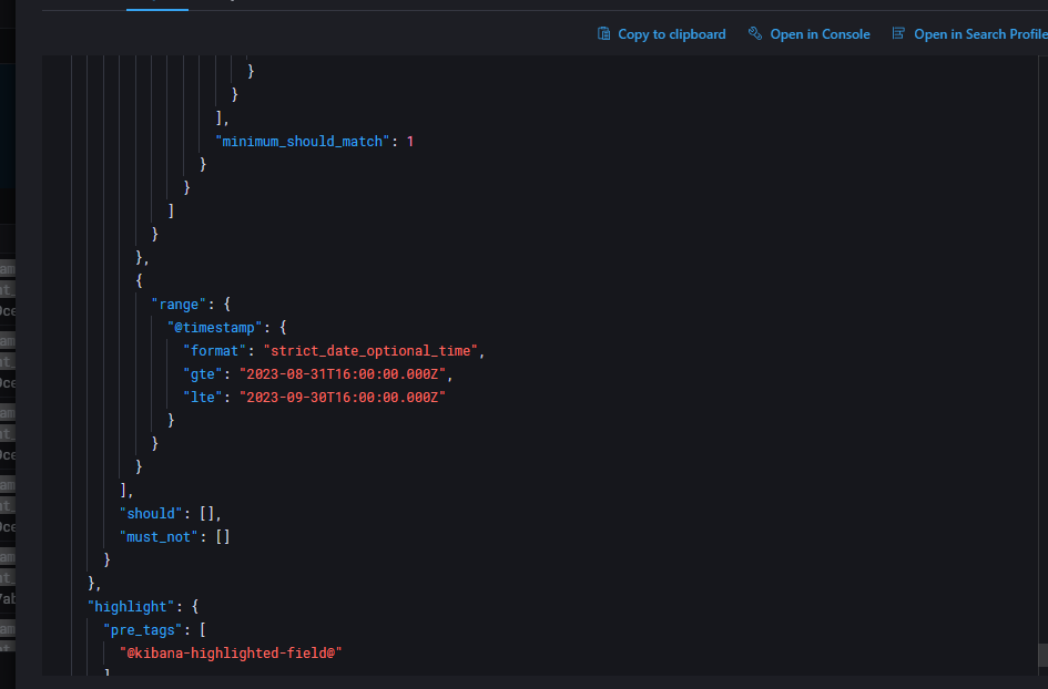

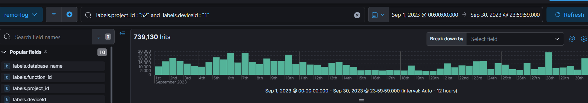

I now found out the date range that I specify in the Discover console Sep 1 00:00:00 to Sep 30 23:59:59:999 is completely different from the query inside inspect request
Inside the inspect query, date range are
"gte": "2023-08-31T16:00:00.000Z",
"lte": "2023-09-30T16:00:00.000Z"
I am not sure why this happened but I think that is the reason that you mentioned which really cause the total hits number has different result.
In Discover:
In inspect request query:

And, thanks for the guide of taking me to the insepct reuqest tab , I now found out the reason which cause the total hit has different result from Discover and dev tool
