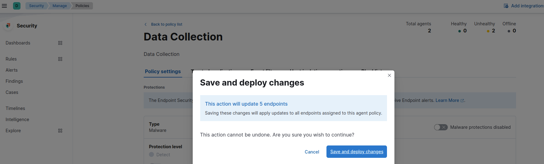

I also tested adding Elastic Defend to the policy of my fleet server, and it worked. I noticed that for the the 'Last updated by' is elastic, while for the (for my fleet server), the 'Last updated by' is system. I'm not sure if this has any impact.
Then, when I clicked to the page of the Data Collection policy (for my Agents), it detected that there are 2 agents which is correct. However, when I clicked the 'save' button, it said it would update 5 endpoints..."
I have no idea what happened to my Data Collection policy
Thanks a lot
