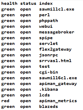

Run the _cat indices and show us what the result is.
Pl find screenshot. Result of above command
indices

You will need to get the index back to green then use delete_by_query as suggested above... Only way to do what you want.
