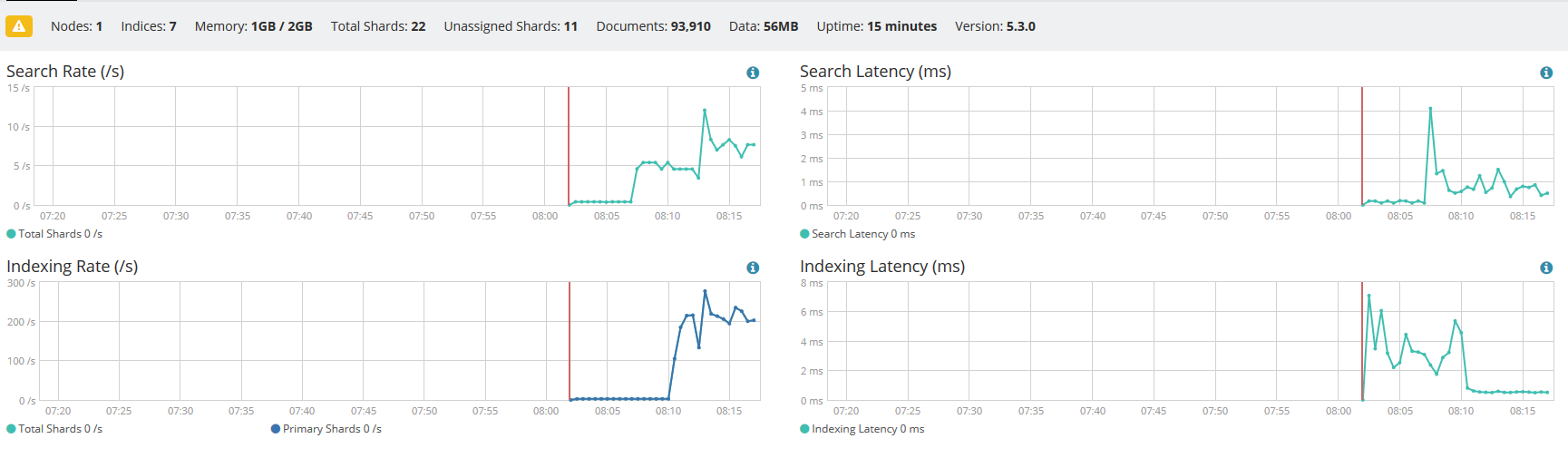

I currently working with elasticsearch for log analysis, my source are IIS logs. I encounter a very slow indexing rate with logstash and elasticsearch. I think I can rule out logstash as problem, since I ran logstash only with stdout and there it was very fast.
My setup ist a single windows computer with 16gb run. One elasticsearch node and kibana running in docker and logstash runs directly on the system. I get arroung 100-300 index/s and I think thats very slow. Is this normal for this setup ? I attached a few statistics.

The 100% "Active Time" for that drive looks poor however. What kind of drive is it? Is it heavily fragmented? A slow drive would definitely slow down the entire pipeline and lead to poor indexing performance.
Thanks for the answer, the drive is a normal 7200 rpm drive. There is only my windows backup on it and the data for elasticsearch.

I played arround with flush size, but it didnt make a diffrence. So I changed the harddrive of elasticsearch to my ssd, now I get arround 1100 / s . Is this expected or should it be faster ?
