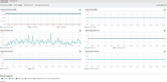

Installed x-pack. Max Heap size is setted to 24 GB. No CPU overloading. Here are screens from x-pack.
