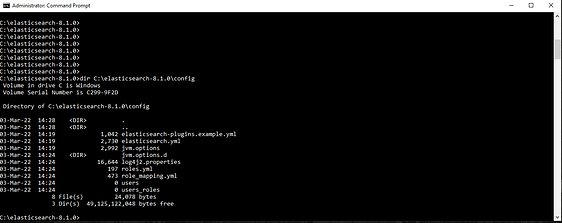

Please share the entire output from starting Elasticsearch, not just this line. Also please share the output of running dir C:\elasticsearch-8.1.0\config Just after you download and unzip the archive

The problem is the program looks for Elasticsearch.yml in the wrong folder -> c:\Elasticsearch-8.1.0\bin\Elasticsearch\Elasticsearch.yml instead of C:\Elasticsearch-8.1.0\config
The Error:
The config dir:
‫בתאריך שבת, 19 במרץ 2022 ב-21:43 מאת ‪Ioannis Kakavas via Discuss the Elastic Stack‬‏ <‪elastic@discoursemail.com‬‏>:‬
