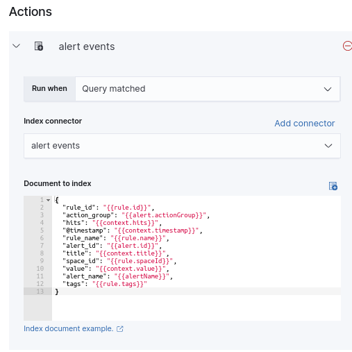

Please find the screenshot, incase something is amiss.
Screenshot from 2021-07-20 14-57-30
