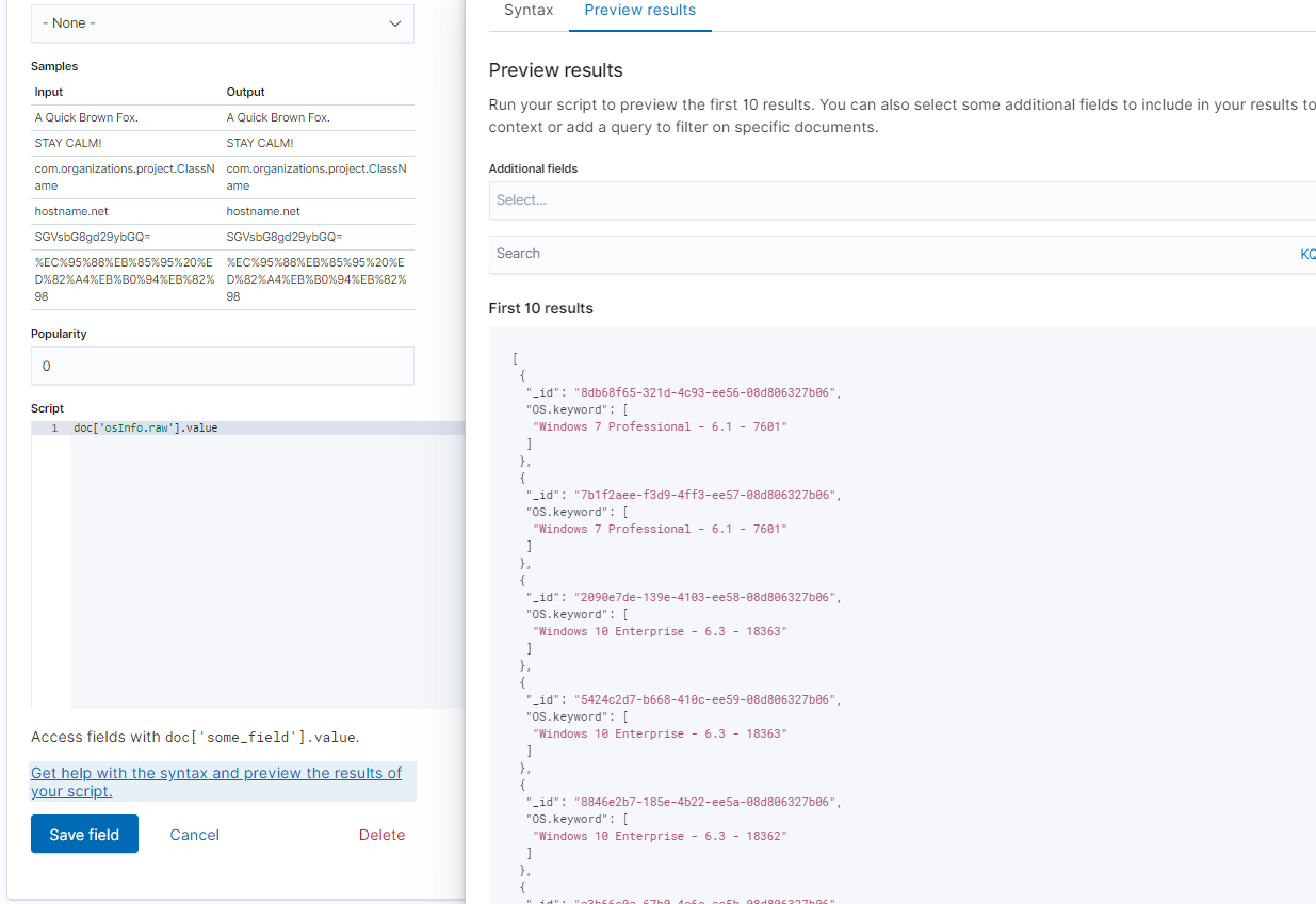

We created a simple string script field, and we are getting a error in discovery and when we try to use that script field in any vizualization.
I belive the images will explain it better:
The script field:
Using the "Get help with the sintax and preview the results" tool:

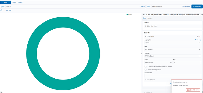

Error in Discovery:
Error trying to use the field in a pie Vizualize:

Are there any null values for osInfo.raw in your entire DB?
Also the error you posted has if(name.contains..... but I don't see that in the scripted field. Looks like the scripted field it's trying to run is more than just the one line I see in the other image.
Attempt to refresh index pattern also.

Abaout the error that have "..name.contains ....." I sorry, I posted the wrong print, the right one is here:
The other print was from another test.
