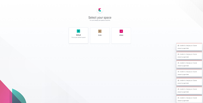

Description of the problem including expected versus actual behavior :
I started Kibana according to the guidance of this document:
kibana-contributing-code
But when I visited Kibana I got an error: Unable to change your Space
Does anyone know what is going on?

Hi @lukeelmers,
Thanks for your reply. Here is the response.
{"statusCode":401,"error":"Unauthorized","message":"Unauthorized"}
BTW, If I use the release version, there is no problem. Same es cluster.

server  respons [12:05:29.960]  GET /built_assets/dlls/icon.logo_metrics-js.bundle.dll.js 200 31ms - 9.0B
server  respons [12:05:29.945]  GET /api/xpack/v1/info 401 49ms - 9.0B
server  respons [12:05:29.972]  GET /built_assets/dlls/icon.logo_security-js.bundle.dll.js 200 51ms - 9.0B
server  respons [12:05:29.946]  GET /logout?next=%2Fapp%2Fkibana%23%2Fhome%3F_g%3D()&msg=SESSION_EXPIRED 200 153ms - 9.0B
server    log   [12:05:30.102] [debug][plugin] Checking Elasticsearch version
server  respons [12:05:30.032]  GET /built_assets/dlls/icon.app_security-js.bundle.dll.js 200 78ms - 9.0B
server  respons [12:05:30.034]  GET /built_assets/dlls/icon.app_spaces-js.bundle.dll.js 200 78ms - 9.0B
server  respons [12:05:29.990]  GET /ui/fonts/inter_ui/Inter-UI-Light-BETA.woff2 200 123ms - 9.0B
server  respons [12:05:30.021]  GET /ui/fonts/inter_ui/Inter-UI-Bold.woff2 200 95ms - 9.0B
server  respons [12:05:30.114]  GET /built_assets/dlls/icon.app_index_pattern-js.bundle.dll.js 200 72ms - 9.0B
server  respons [12:05:30.116]  GET /built_assets/dlls/icon.app_saved_objects-js.bundle.dll.js 200 71ms - 9.0B
server  respons [12:05:30.124]  GET /built_assets/dlls/icon.app_console-js.bundle.dll.js 200 64ms - 9.0B
server  respons [12:05:30.125]  GET /built_assets/dlls/icon.app_index_rollup-js.bundle.dll.js 200 72ms - 9.0B
server  respons [12:05:30.033]  GET /logout?next=%2Fapp%2Fkibana%23%2Fhome%3F_g%3D()&msg=SESSION_EXPIRED 200 167ms - 9.0B
server  respons [12:05:30.198]  GET /built_assets/dlls/icon.app_watches-js.bundle.dll.js 200 10ms - 9.0B
server    log   [12:05:30.233] [debug][server][Kibana][cookie-session-storage][http] Error: Unauthorized
server    log   [12:05:30.238] [debug][basic][plugins][security] Trying to authenticate user request to /bundles/app/logout/bootstrap.js.
server    log   [12:05:30.238] [debug][basic][plugins][security] Trying to authenticate via header.
server    log   [12:05:30.238] [debug][basic][plugins][security] Authorization header is not presented.
server    log   [12:05:30.239] [debug][authentication][plugins][security] Could not handle authentication attempt
server  respons [12:05:30.231] [api] GET /bundles/app/logout/bootstrap.js 200 18ms - 9.0B
