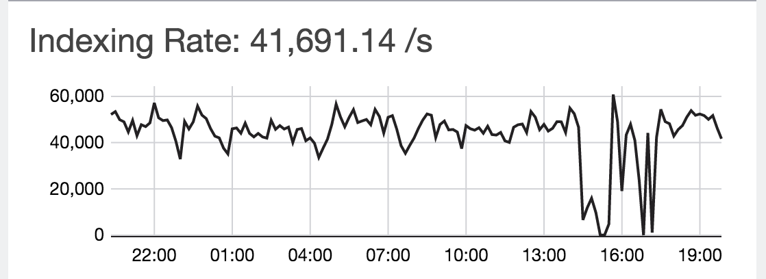

I get periodic dips in my indexing rate, which I suspect is due to segments merging. The index rate will dropped dramatically periodically. Here is what I mean.
First is the 15 min window to show that I see the same graph you are. It's a bug in Marvel graphing.
The first time I saw this several weeks ago, I thought something went wrong till I zoom back out. As you can see, it show that indexing has stopped for sometime.

I have encountered the same problem with periodical drops of the indexing rate. When you "zoom out" you just change the interval Marvel uses to calculate the indexing rate.
