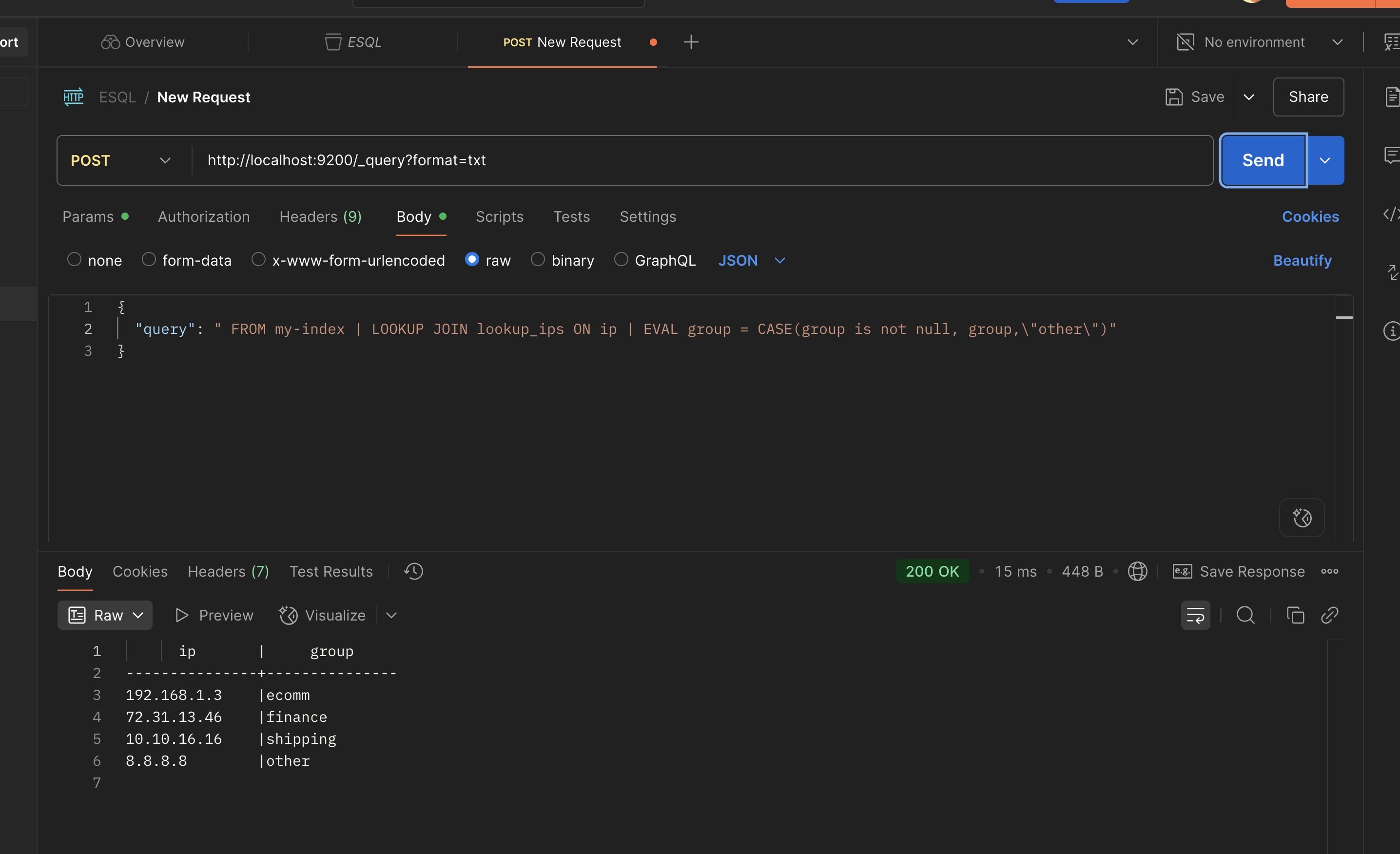

Hi @pruna Welcome to the community...
Use raw with type json
The triple quotes don't work that is a kibana convention so yours will be
    "query": "FROM facts | WHERE DATE_PART('month', date_start) = '06'"
Hi @stephenb , thank for the welcome, and the fast response! Yes, I was using raw. The change from triple quotes to just double quotes and one line did the trick.

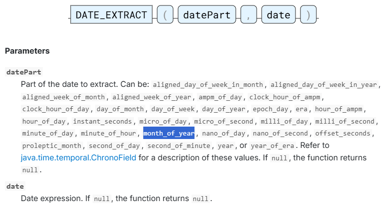

Hello @pruna
I tried below and was able to extract the logs for particular month :
FROM kibana_sample_data_logs
| WHERE DATE_EXTRACT("month_of_year", @timestamp) == 6
Thanks!!

    "query": "FROM anniversaries | WHERE DATE_EXTRACT(\"month_of_year\", date_start) == 7 AND DATE_EXTRACT(\"day_of_month\", date_start) == 14"
