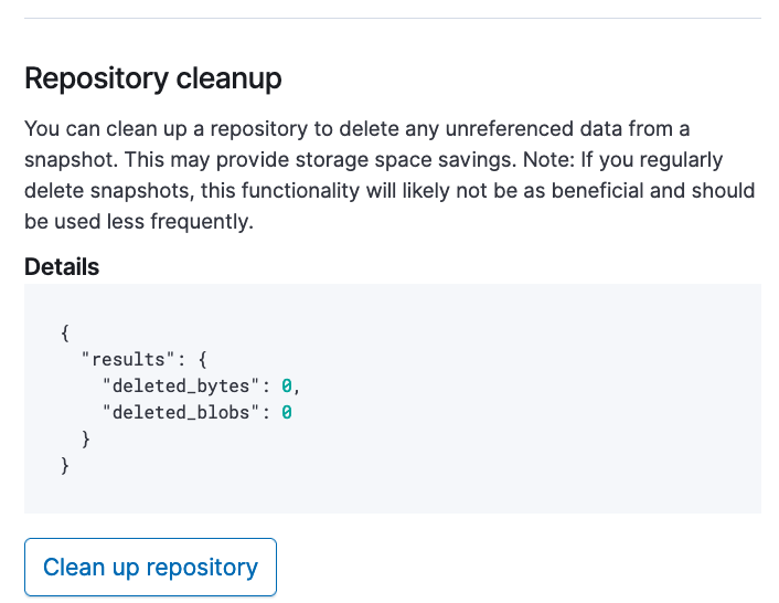

ES snapshot fails on Azure - even though repository is fine and working
  1. Verification status says connected
  2. I already did clean up
  3. When I try to list the repo in DevTools (in Kibana), it gives me timeout
