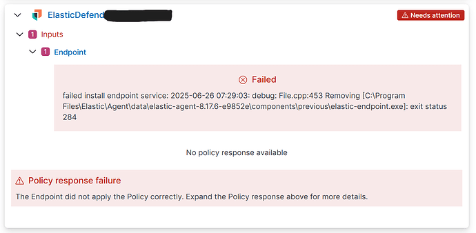

So... I also tried to reinstall the agent with Elastic Defend policy and I got the error in the image.

Update.
I have no idea if this is a solution that will work for everyone.
Status: I tried uninstalling the Elastic Agent with Elastic Defend integration. Elastic Agent was installed but Elastic Endpoint was not.
Update: I re-installed the policy and then did uninstall via powershell. And it worked.
I no longer have Elastic Agent and Elastic Endpoint on my computer
Hi @ArgoAdvisory Did you have tamper protection enabled in your agent/endpoint policy?
hi @NickFritts yes, I have tamper protection enabled.
Maybe I know what you mean: I know that to uninstall Elastic Endpoint you need the token.
The main problem is that initially I didn't want to uninstall it, I just wanted to disable it by putting the agent in a policy without Elastic Defend.
But when I moved the agent to this new policy, the Elastic Endpoint service continued to run.
So I tried to uninstall it, but without success.
So I move again the agent to the old policy, and then I uninstalled everything via powershell with the token.
I hope I was clear, if you want more information I'm at your disposal.
Thank you!
@ArgoAdvisory please note that the Endpoint service also has command line interface, therefore you could just uninstall such stray Endpoint with the uninstall token.
As for the situation, one of the two should hold:
  • Agent should not allow you to move to policy without Endpoint (Defend) if Tamper Protection is enabled
  • Agent should remove Endpoint when moving to policy without Endpoint (whether Tamper Protection is enabled or not)
Thank you for reporting the issue.
