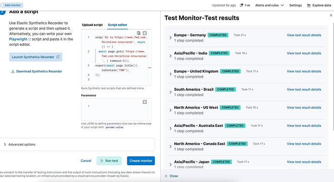

So with little modification i have been able to run the script you provided. Though i am unable to recreate Navigation failed because page crashed! error this seems most likely an issue with webpage itself. Would you be able to provide more info, when you see that error?
Regarding script even though we are using playwright, our assertions are bit different so title assertion will work like this
expect(await page.title()).toContain("FWD");
We are working to support all assertions. here is more about this difference Write a synthetic test | Observability Guide [master] | Elastic

I found out that the same script is working when using location from Elastic Infra.
However, it fails when we choose a private location.

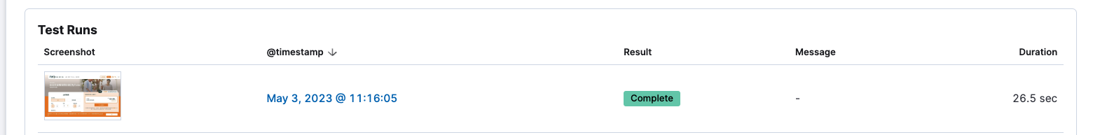

Hi @vigneshshanmugam ,
Thanks so much!
After increased the memory to 2G (of the pod), it runs successfully!
