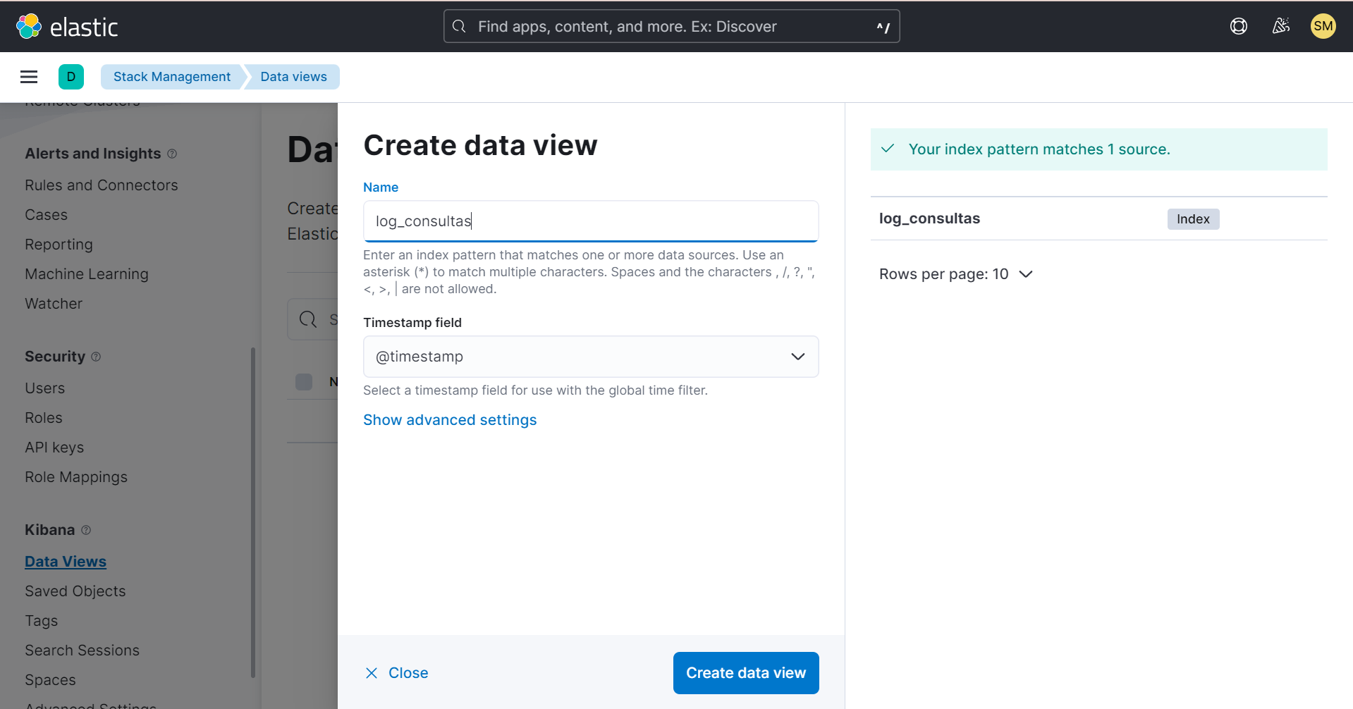

After this I created a new Data View call log_consultas
but then when I try to create visualizations in the dashboard this comes up
Can anyone help me? What I'm missing? Any suggestions would be great!

Did you check the date interval covers the data you indexed?
