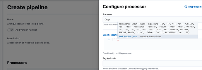

I am trying to create a simple ingest pipeline in Kibana but can not figure out what syntax the condition will accept and there is no documentation that I can find.
I know how to specify what I want in the API but nothing I have tried in the condition box is accepted.
I get as far as "if" then it seems to want "()", and after that anything I type inside the () is flagged as an error.
what I want is if (field =='value')
I really wish there was a way of just entering the condition as it would appear in an API request!

I am trying to do this from in Kibana, not the API. Kibana appears to use a different syntax which does not appear to be documented anywhere. The UI has a "smart" (dumb ? ; ) syntax checker that flags anything it does not like as soon as you type it. When you hover over the flag (~) it tells you what the possible things that can go there. Using this worked out it must start with if () but whatever I type next produces and error even though STRING is one of the options ???
As I said in my original post I can do this in the API by I want to use Kibana ( so that other, less technical people, can maintain it)

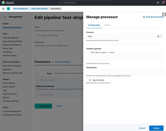

EDIT Ahhh I guess you are using the Kibana - Stack Management - Ingest Node Pipelines GUI :slight_smile:
(Sorry I rarely use that)
You can do full painless but if you just have simple conditions you just put in right hand side of the if block without the double quotes
      "drop": {
        "if": "ctx?.object_type == 'disk'"
just put in
Ah! I am navigated this way:
home => management => ingest node pipeline => create
It had not occurred to me that there was more than one way of doing this in kibana.
Apologies for the disconnect!
No Worries... we were both assuming.. :slight_smile:
I did see the syntax "helper" yeah... a bit less than always helpful.
So what I usually do is create the pipeline in Dev Tools, then take a look in the GUI... see what it looks like... but mostly I like the Dev Tools

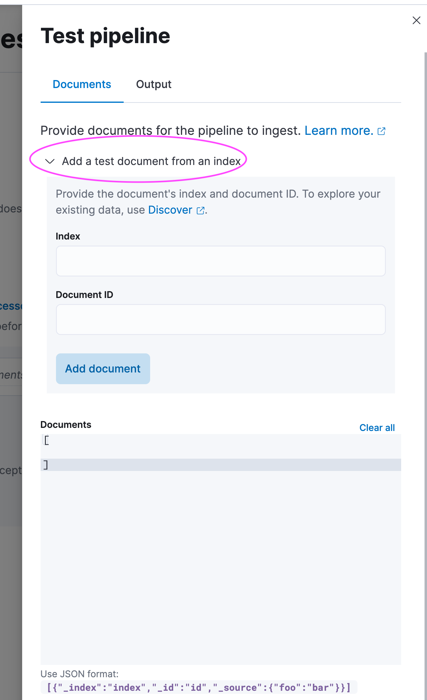

BUT The GUI does have a kinda cool way to test the pipeline sort of equivalent where you can put in your own test documents or actually
test a document from and existing index.
