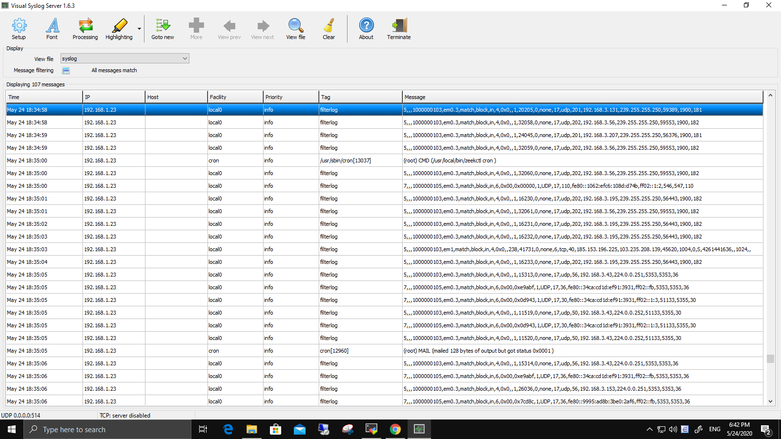

My pfsense config:
It's connected as syslog show. But I can't find any log come from pfsense.

I use a visual syslog server on Windows and receive log but my ES server does not.
