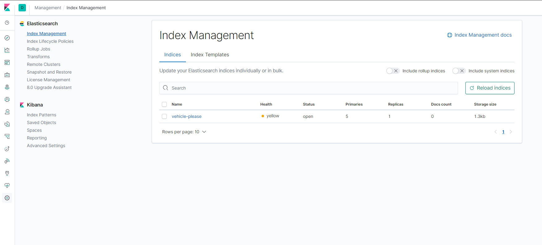

I am trying to pass the log file from the beats to the Elasticsearch.
my problem is that even though the beats harvest the log file from the log directory, there is no update in Elasticsearch index management in Kibana.
The number of docs and the size of storage didn't increase.
it didn't show me any error, so it is hard to figure out what is the problem.

Hi,
First of all, there was no error showed up in Logstash output, it is pretty tough to address it.
But, thankfully, the problem was solved.
The way to solve it is that the log file should has more than one line in each file.
So, I want to ask do you know why does it happen?
Why the Elasticsearch didn't go through the process when the log file has only one line?
